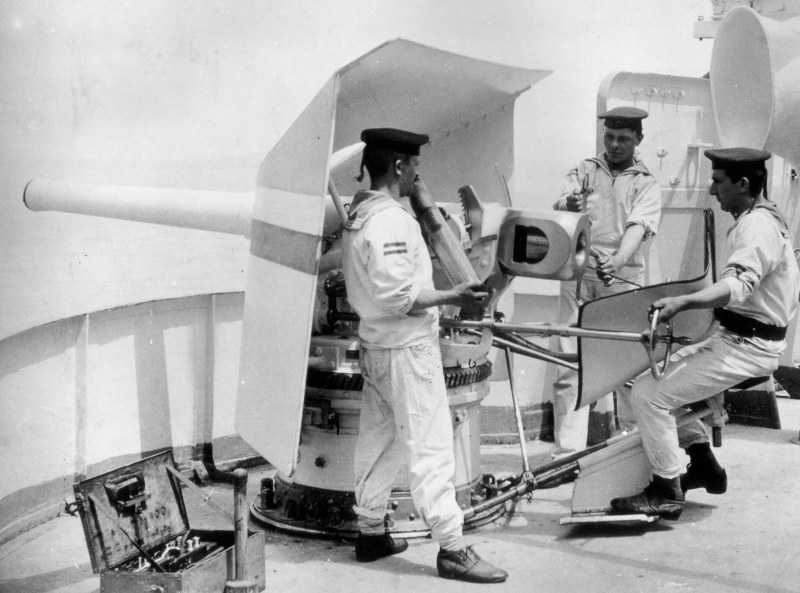

8.8 cm/35 (3.46") SK C/35 on Armored Cruiser Vineta
Paint scheme appears to be that of the sub-Asiatic Squadron
Note the shield to protect the gunner from the ejected cartridge case
Photograph courtesy of Peter Lienau
