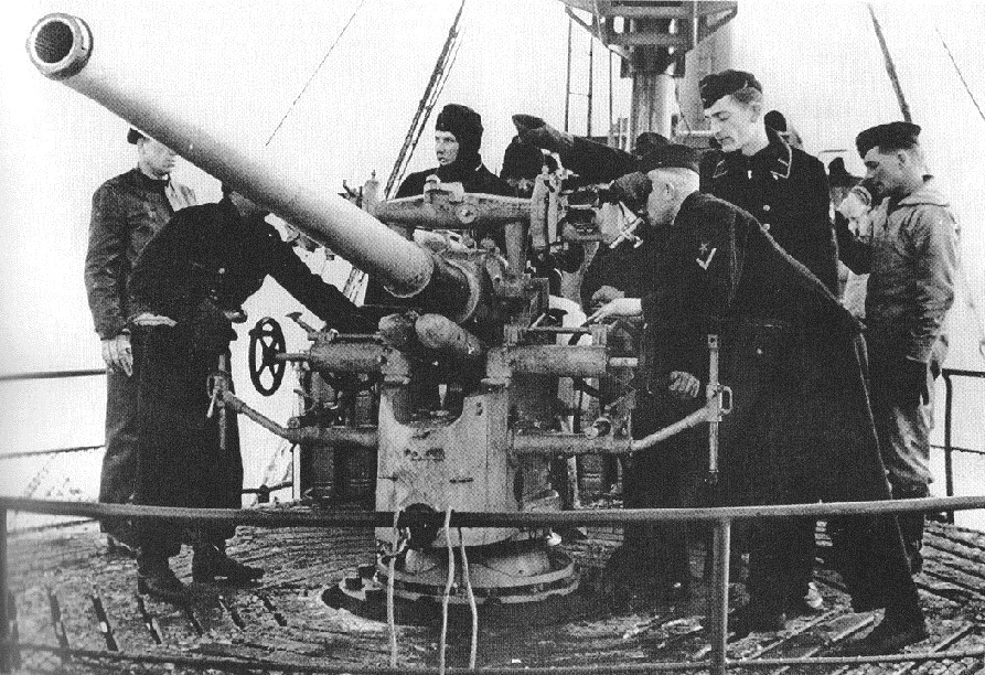

8.8 cm/45 SK/C30 gun in Flak L C/30 pedestal mount on bows of "KFK" class auxiliary ship
CAW Collection Photograph
