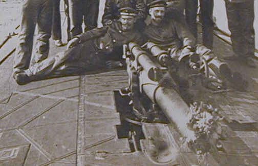

8.8 cm/30 (3.46") Ubts L/30 in lowered position

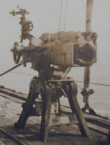

Rear view of 8.8 cm/30 (3.46") Ubts L/30 showing the collapsible mounting
