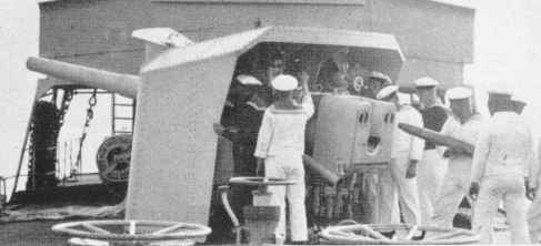

10.5 cm gun on Training Ship Bremse

   Bremse (4) and Wolf (3):  MPL C/30
Elevation -10 / +30 degrees
