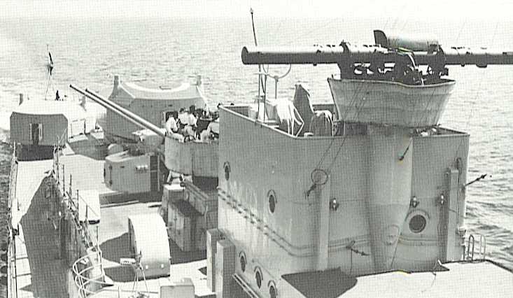

An unsuccessful anti-aircraft gun carried for a brief time on the Königsberg light cruisers.  Replaced by single 8.8 cm/45 SK L/45 guns.
8.8 cm/75 Twin Mount on Köln
Note main rangefinder at upper right, flak rangefinder at center and Reichsmarine flag on fantail
