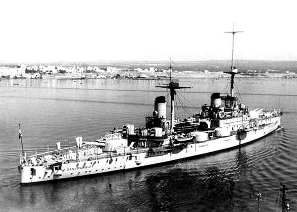

Armored Cruiser San Giorgio in 1941
The 10" (25.4 cm) guns are in the bow and stern turrets
Marina Militare Photograph
