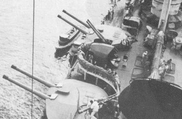

Armored Cruiser San Giorgio in 1941
The twin 7.5" (19.1 cm) guns are in the two lower mountings
Above and between them is a twin 10 cm/47 OTO M1928 AA mounting
Photograph copyrighted by Elio Andò

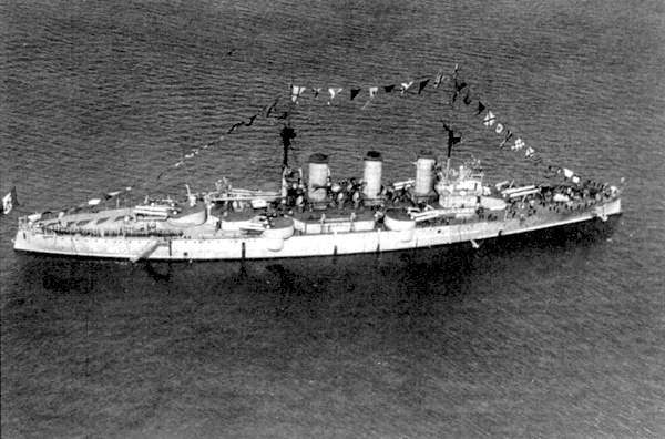

Armored Cruiser Pisa in 1923
Twin 7.5" (19.1 cm) guns in four amidships mountings
Marina Militare Photograph

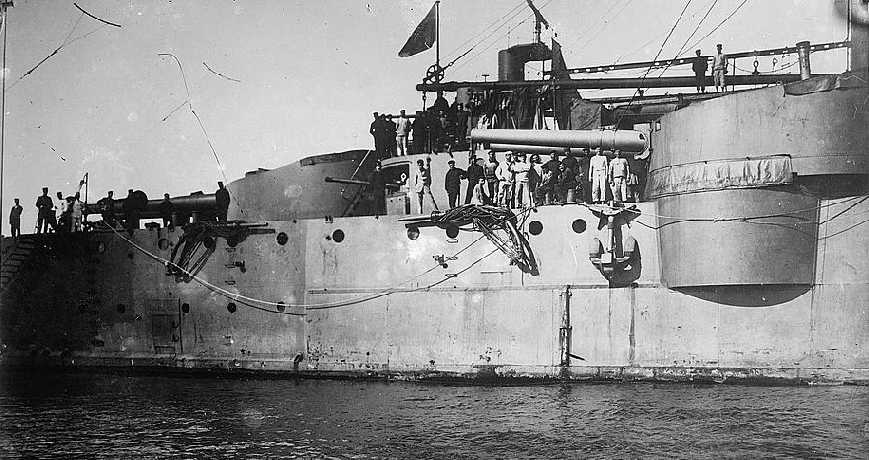

10"/45 (25.4 cm) and 7.5"/45 (19.1 cm) turrets on Pisa circa 1915
Note the 3"/40 (7.62 cm) gun in casemate mounting
Bain News Service Photograph
Library of Congress Photograph ID LC-DIG-ggbain-10036
