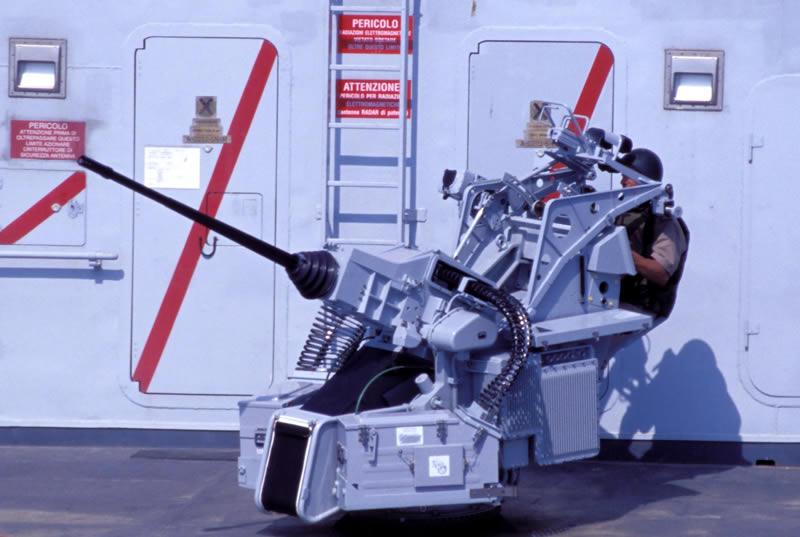

This weapon system is a result of a collaboration between OTOBreda (now OTO-Melara) and Oerlikon Italiana.  It is intended to replace older 20 mm Oerlikon weapons and fires much more powerful ammunition.  The Power Assisted (PA) Naval Mounting for this weapon provides hydraulic power assistance such that the gunner needs only to apply as much force as it would take if the ship were not moving at all.  The gunsight adjusts automatically so that the gunner can remain standing instead of crouching down when the gun is at high elevations.

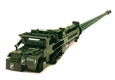

The gun itself is an Oerlikon KBA which is belt fed with dual feed.

25 mm in Power Assisted Mounting
Photograph copyrighted by OTO-Melara

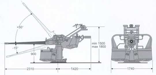

Sketch of Power Assisted Mounting
25 mm KBA Gun
Photograph copyrighted by Oerlikon Contraves AG

Designation 25 mm Power Assisted (PA)
25 mm Compact Single or Twin
Weight  Power Assisted - empty:  2,050 lbs. (930 kg)
Compact:  N/A
Elevation Power Assisted:  -15 / +50 degrees
Compact:  -13 / +80 degrees
Elevation Rate Power Assisted:  N/A
Compact:  75 degrees per second
Train Rate Power Assisted:  N/A
Compact:  130 degrees per second
1) The Power Assisted mounting was originally designed for two 80-round ammunition boxes.  Later, 96-round boxes were designed and now a newer version can carry two 126-round boxes.  A box with 96 rounds weighs 132.3 lbs. (60 kg).  This mounting uses a 24 Vdc lead-acid battery which is recharged from the ship's power supply.
