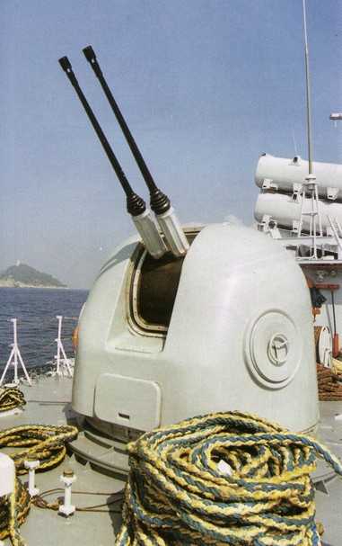

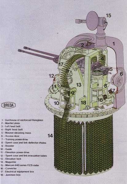

This weapon is based upon the German Mauser MK 30 mm Model F gun and uses standard NATO ammunition.  Effectively, this weapon is a scaled-down version of OTO-Breda's 40 mm/70 mounting.  These mountings for these weapons are unmanned, gyro-stabilized and joystick controlled.  The optical sighting system is line-of-sight stabilized with the aim-off automatically calculated while the target is kept in sight.  OTO-Breda (now OTO-Melara) claimed that this system is effective against surface targets at ranges up to 3,000 meters (3,300 yards).
OTO-Melara currently offers these weapons in either single or twin above deck mountings with local or remote control or in Compact-style mountings with below-deck magazine.  These mountings are also shared with the 25 mm Compact.

Twin 30 mm/82 Compact
Experimental Corvette Saettia built by Fincatieri
Photograph copyrighted by OTO-Melara

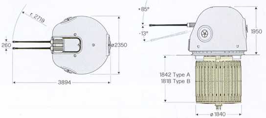

Sketch of Twin 30 mm/82 Compact

Twin 30 mm Compact Naval Mount
   Type A
   Type B
Twin Sea Cobra
Weight  Without Ammunition
   559:  3,307 lbs. (1,500 kg)
   564:  4,034 lbs. (1,830 kg)
   563:  4,167 to 4,365 lbs. (1,890 to 1,980 kg)
   Type A:  7,275 lbs. (3,300 kg)
   Type B:  7,055 lbs. (3,200 kg)
