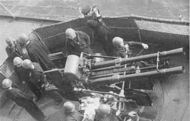

37 mm/54 in Model 1932 twin mounting on a Zara Class cruiser
Photograph copyrighted by Elio Andò

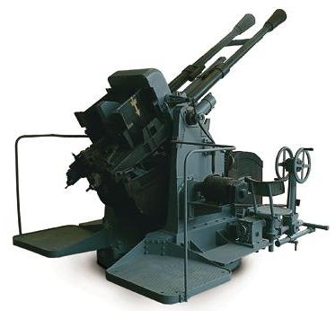

Photograph courtesy of Museo Nazionale della Scienza e della Tecnica

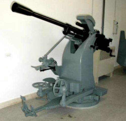

37 mm/54 in RM 1939 mounting
Photograph by Aldo Fraccaroli and courtesy of Museo Nazionale della Scienza e della Tecnica

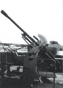

Single 37 mm/54 RM 1939 formerly on a Capitani Romani light cruiser

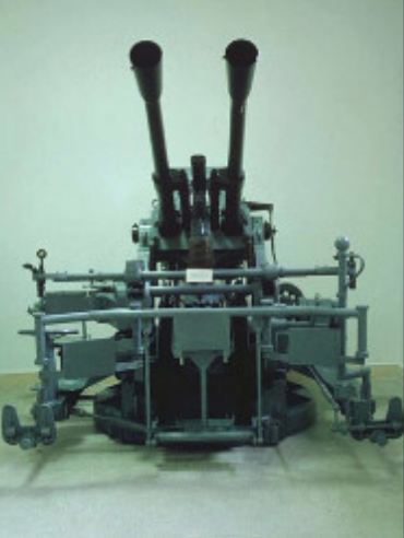

Twin 37 mm/54 formerly on the battleship Vittorio Veneto
