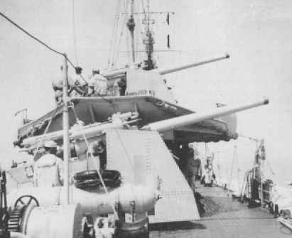

100 mm/47 OTO 1937 guns on Torpedo Boat Ariel
Photograph copyrighted by Elio Andò
100 mm/47 Model 1937 formerly on the Corvette Ibis
In the background is a twin 100 mm/47

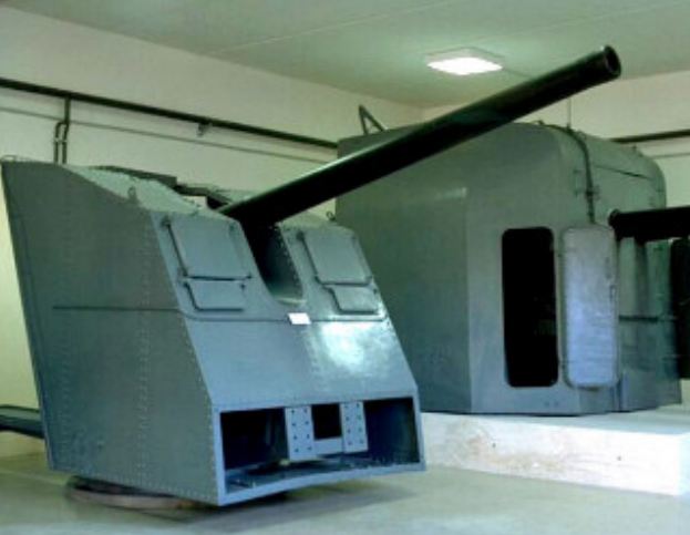

16 May 2006 - Benchmark
23 September 2012 - Added picture of musuem gun
