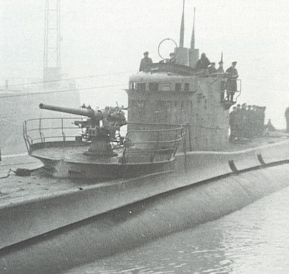

100 mm/47 OTO 1937 guns on Argo in 1942
Photograph copyrighted by Elio Andò

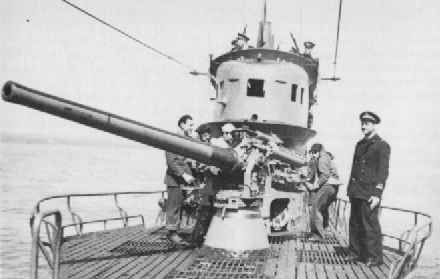

100 mm/47 on Torelli at St. Nazaire in December 1941
Photograph by E.C.P. Armées

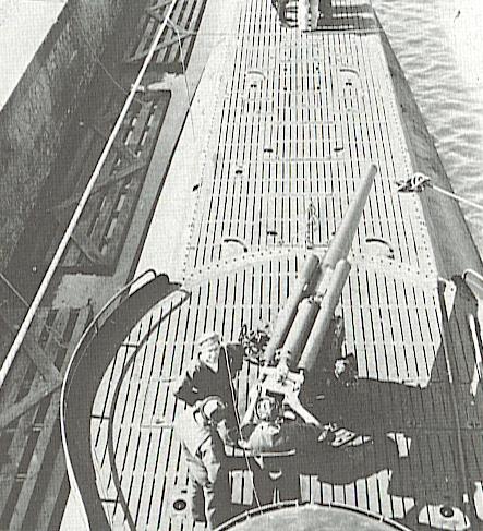

100 mm/47 on unidentified Marconi class submarine at Bordeaux circa 1941

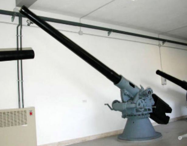

23 September 2012 - Added picture of museum gun
