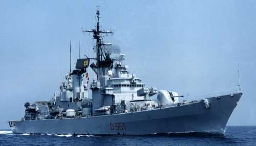

MM Audace
127 mm/54 (5") Compact is the bow mounting
Official Marina Militare Italiana (Italian Navy) photograph
