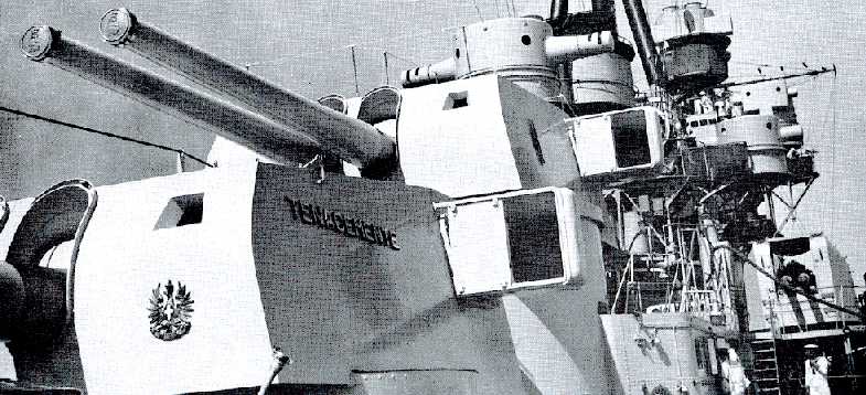

Stern Turrets on Heavy Cruiser Bolzano
Marina Militare Photograph

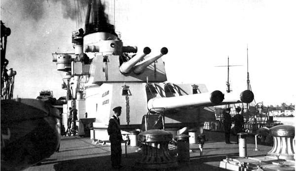

Stern turrets on Heavy Cruiser Zara
Note the rangefinders
"Tenacemente" means "Tenaciously"

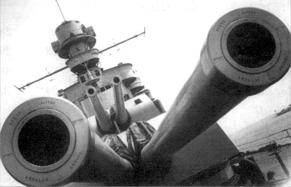

Bow guns on Heavy Cruiser Zara
Note the muzzle engravings
