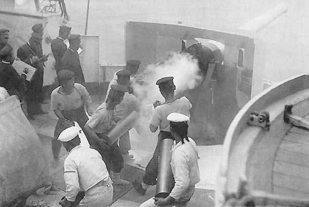

Japanese 6"/40 (15.2 cm) gun in action
Note the observers at left, this appears to be a prize shoot
