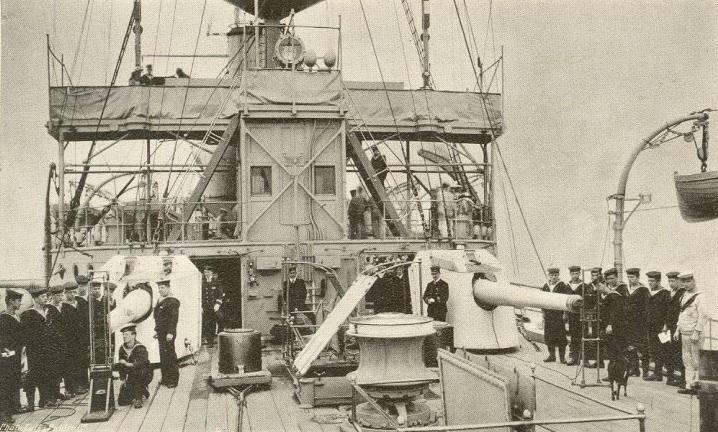

6"/40 (15.2 cm) guns on HMS Hermes
The original postcard is titled "Captain Scott's Dotter" which was a mechanism used to teach gunsighting techniques
Photograph courtesy of Brian Cave and Paul Benyon

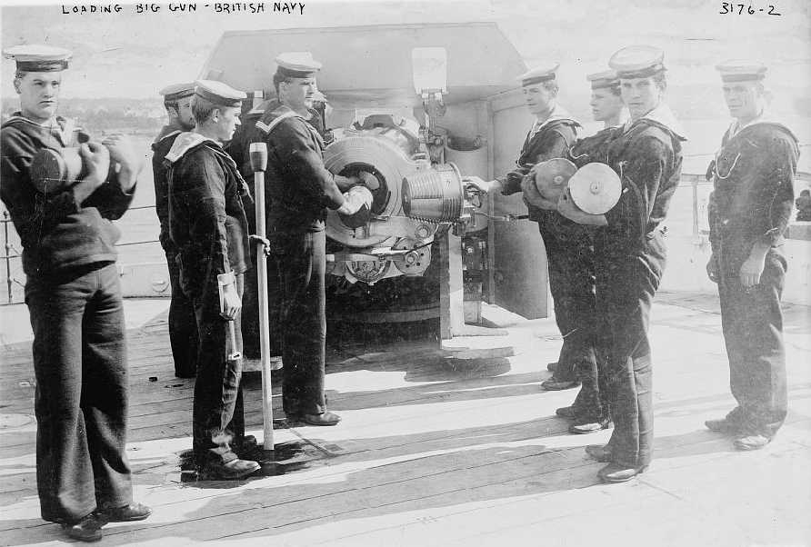

6" (15.2 cm) gun on HMS Ariadne ca. 1903
Note the three motion breech and sailors holding rammer, projectile and propellant casings
Bain News Service Photograph
Library of Congress Photograph ID LC-DIG-ggbain-16785
