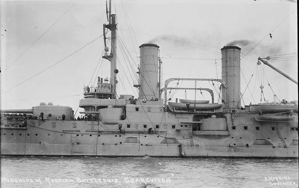

Battleship Tsesarevich about 1900
Admidships turrets hold twin 6"/45 (15.2 cm) guns
Caption reads "Midships of Russian battleship Czarevitch"
Bain News Service Photograph
Library of Congress Photograph ID LC-DIG-ggbain-16925

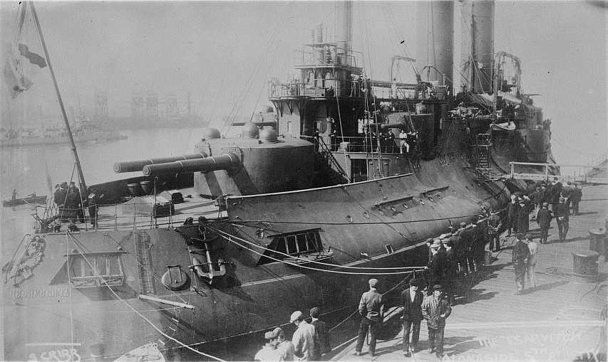

Stern turret on Tsesarevich about 1900
Caption reads "The Tsar[e]vitch alongside 5th [...] Jetty"
Library of Congress Photograph ID LC-B2- 2903-14

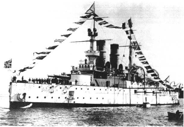

Imperial Russian Navy Battleship Sissoi Veliki
Sissoi Veliki was the first modern pre-dreadnought in the Russian Fleet
U.S. Naval Historical Center Photograph # NH84780
