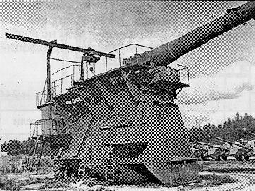

Russian Test Platform for the 14"/52 (35.6 cm)
Picture from "Encyclopedia of Russian Artillery"

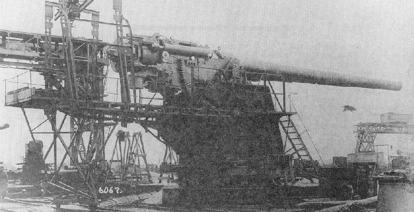

Another 14"/52 (35.6 cm) on a Russian Test Stand

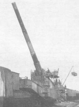

14"/52 (35.6 cm) TM-1-14 railway mount during World War II
Photograph from "Izmail - Super Dreadnought of the Russian Empire"

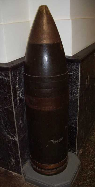

14"/52 (35.6 cm) HE now at Central Naval Museum, St. Petersburg, Russia
