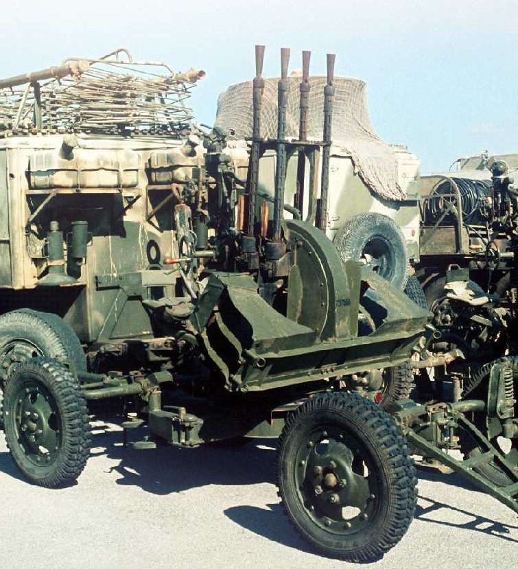

A Soviet-made ZPU-4 quad 14.5 mm anti-aircraft machine gun
U.S Defense Department Photograph No. DD-ST-85-01308

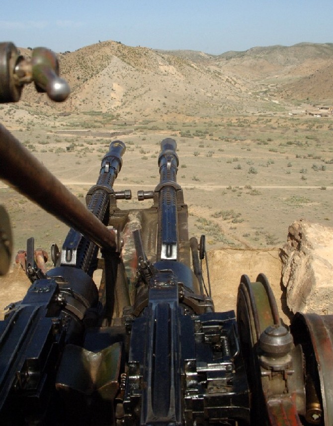

070327-A-2394G-086
A Chinese copy of a Russian ZPU-2 twin 14.5 mm Anti-Aircraft Gun System at border checkpoint 7 in the Tirzaye District in the Khowst Province of Afghanistan in March 2007
U.S Army Photograph No. 070327-A-2394G-086
