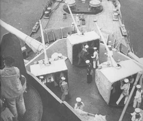

76.2 mm (3") 34-K guns on Battleship Marat

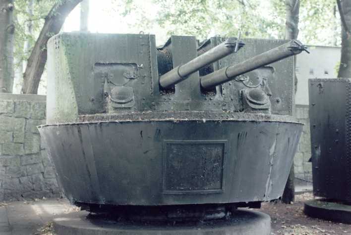

Twin 76.2 mm/55 (3") 39K mount from the destroyer Wicher II (ex. Skoryj)
Exposition of Navy Museum, Gdynia
Photo copyrighted by Michal Kopacz
