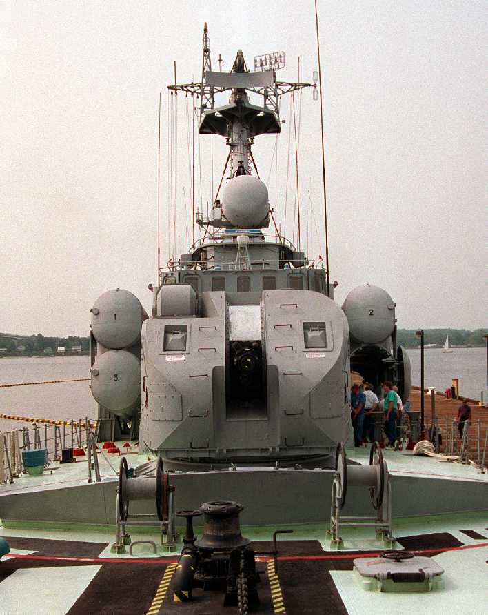

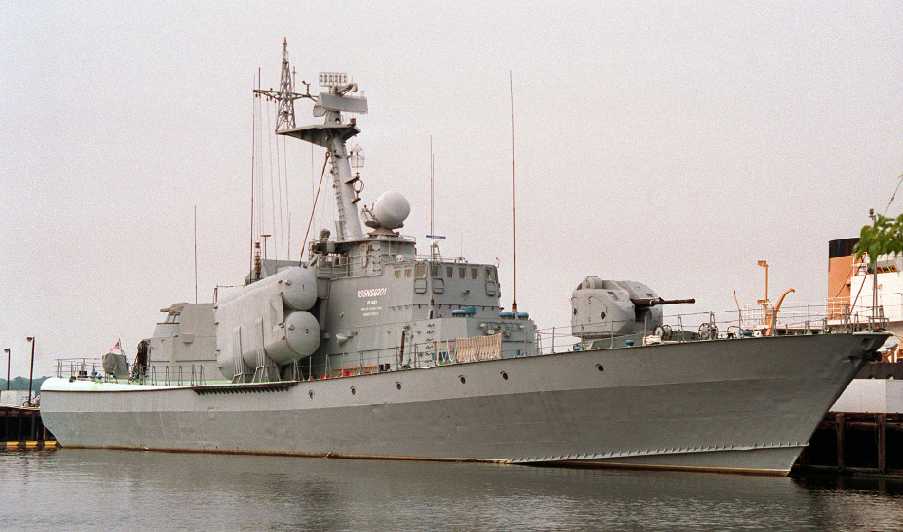

USNS Hiddensee, a Tarantul I class missile corvette, shown in 1993 while moored at the Naval Sea Systems Command facility at Solomons Annex
U.S. Navy Photograph No. DN-SC-93-05847

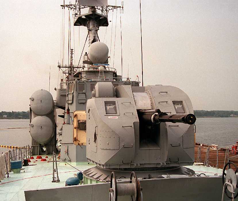

76 mm AK176 aboard USNS Hiddensee
U.S. Navy Photograph No. DN-SC-93-05852
Missile launchers are for P-15 SS-N-2c Styx Missiles

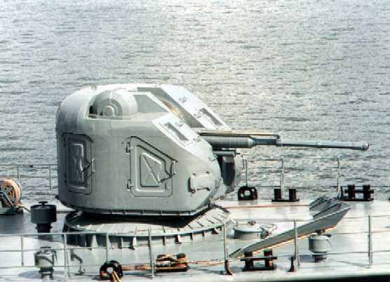

U.S. Navy Photograph No. DN-SC-93-05851
76 mm/60 (3") AK-176
Picture courtesy of Jacek Krzewiñski
