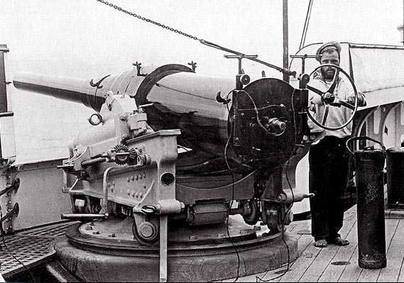

6"/35 (15.2 cm) Pattern 1877
Note powder canister and bare feet

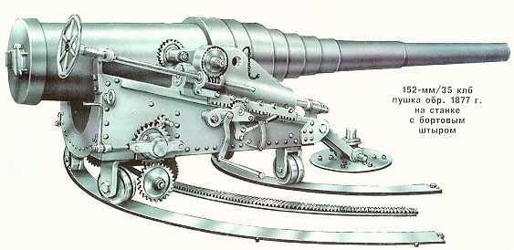

The built-up construction of this weapon is clearly evident in this sketch
