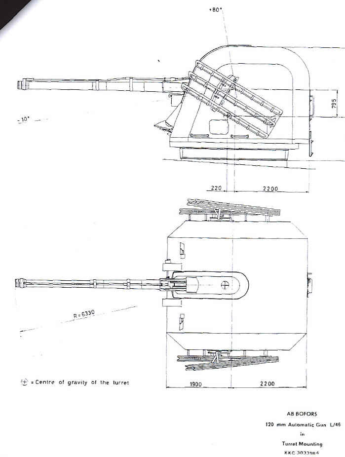

Bofors sketch of 120 mm/46 TAK120
Dimensions are in millimeters

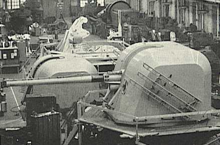

120 mm/46 TAK120 guns under construction
Rails on sides are for rocket flares
