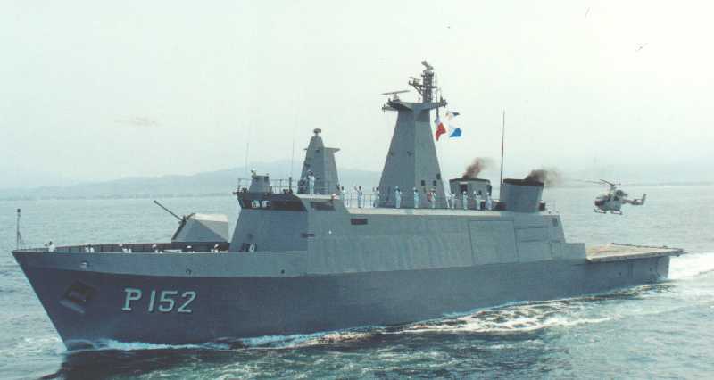

 Mexican Navy Sonora
Photograph copyrighted by Bofors Defence
