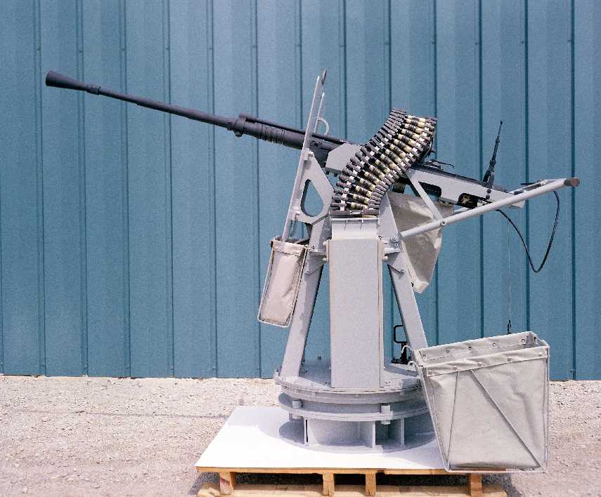

20 mm Mark 16 Mod 5 mounted on a Mark 67 Mod 1 gun mount in March 1971
U.S. Navy Photograph No. DN-SC-90-01951
