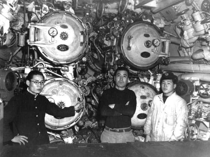

Forward torpedo room of I.58 on 28 January 1946 while awaiting scuttling at Sasebo, Japan
This submarine torpedoed and sank USS Indianapolis (CA-35) on 30 July 1945
USMC Photograph # 139986
