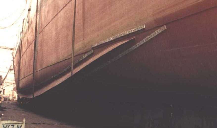

The damage was relatively minor (Picture of damaged area) and the Missouri was quickly repaired and was able to proceed on a previously scheduled training cruise in mid-February.  However, for years there have been persistent rumors that her keel had been badly bent and that she was limited to no more than 15 knots for the rest of her life.  One of the biggest rumors has been that one of the 16" (40.6 cm) turret barbettes, a round cylinder made up of Class A armor between 11.6 and 17.3 inches (29.5 to 44.0 cm) thick, was badly cracked as a result of the grounding.

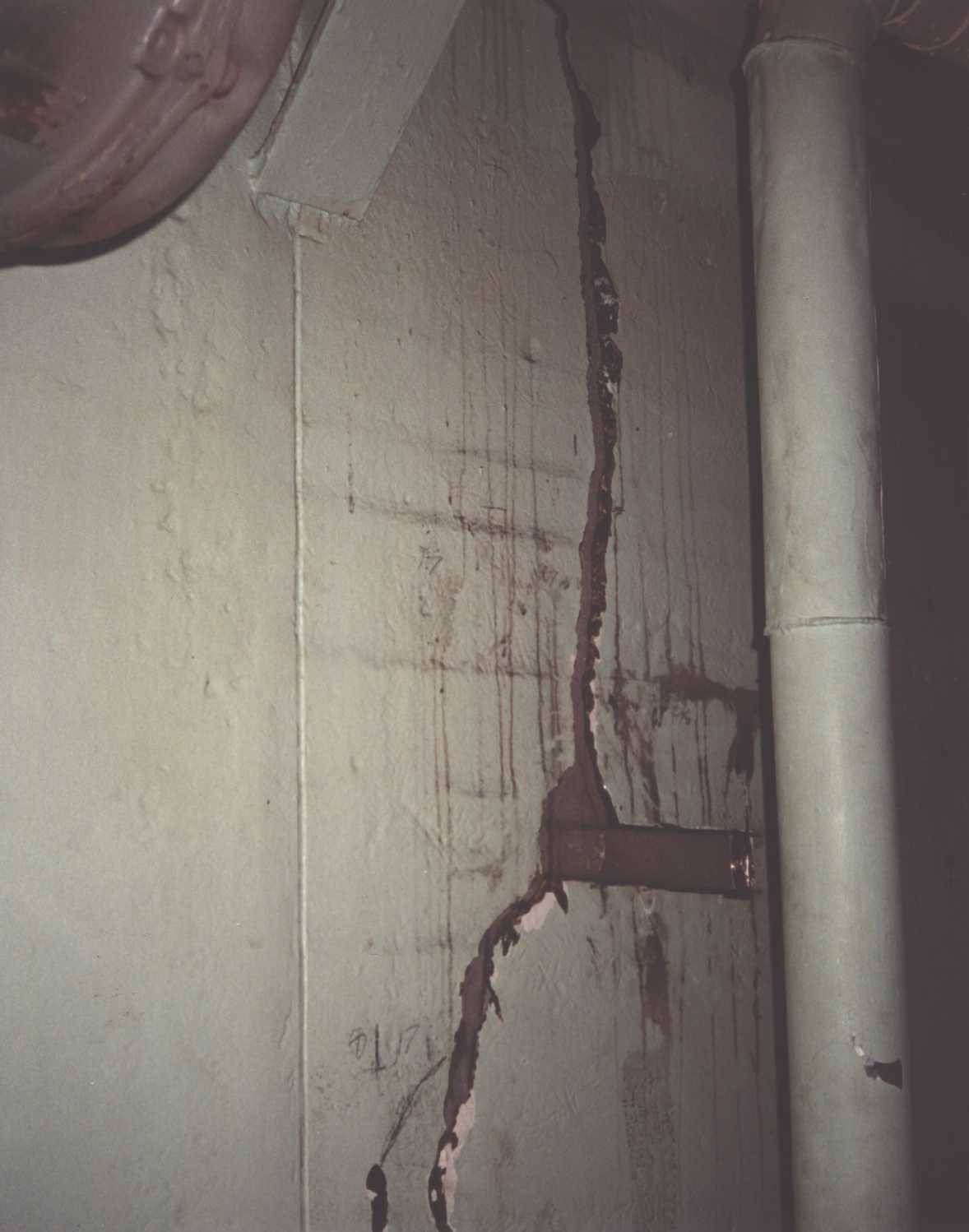

In 1982 and in 1983 we did shipchecks of Missouri as she was still laid up in Reserve in Bremerton, Washington.  On the first trip I photographed the crack in the starboard side of the barbette.  (Picture 74KB)
Prior to that, NAVSEA had also inspected the crack and cut a rectangular coupon out of it for analysis.  I wish they had called me first because I had all the manufacturer's specs as to the analytical content of the class A armor (thanks to Nathan Okun in Oxnard, California for supplying them).  That coupon cut with the square corners to concentrate stresses was just asking for more cracks to emanate from the corners.

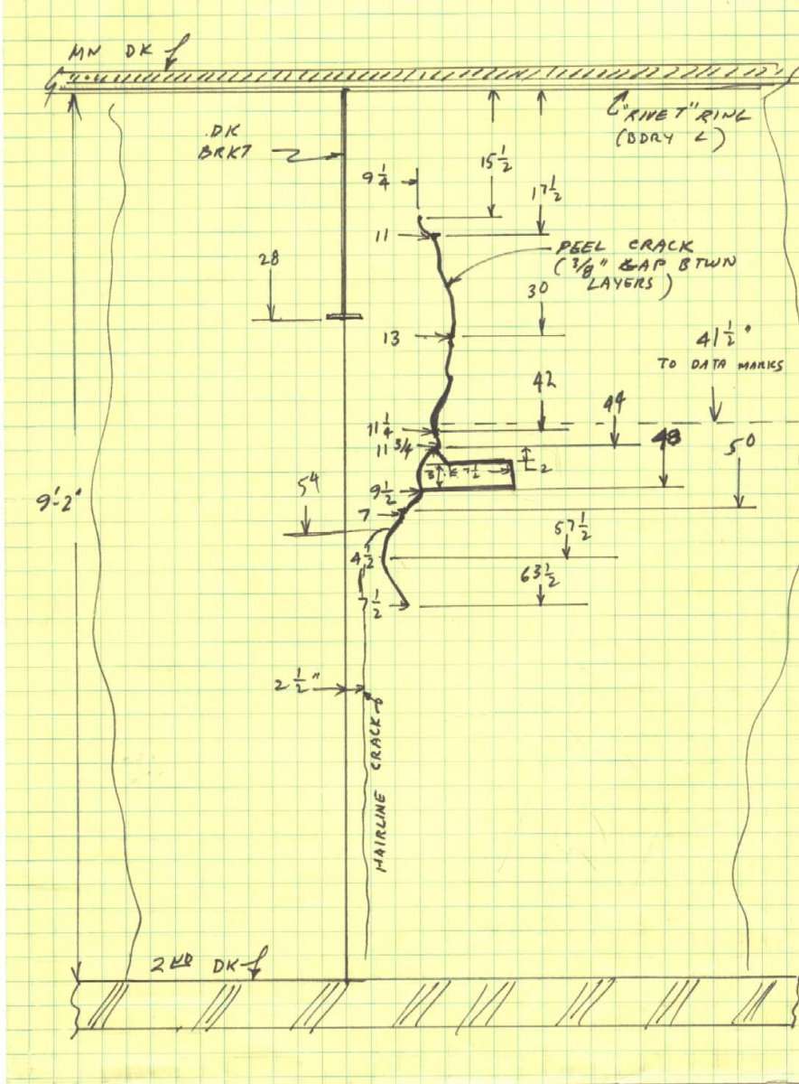

Additionally, NAVSEA also X-rayed the barbette panel to see how deep the crack went.  Their readings were still written on the side and I copied them all down.  I also measured the exact shape and size of the crack using grid dimensions from the aft panel butt and down from the underside of the main deck.  (Picture 90KB)

Now, for the cause of the crack.  It is actually a laminar separation of the heat treated face of the class A armor.  The face was carburized and hardened to a 540 Brinnel hardness up to 40% of the depth of the plate.  The barbette panel is 17.3 inches thick and the laminar separation went no more than 6 inches deep, thus proving it was within the outer 40% heat treated depth.

THREE:  It was NOT the centerline keel that was damaged. It was the BILGE keel. Two slivers of 3/8" thick plate riveted together as a V shape to help stabilize the ship as anti-roll planes. Most of the seriously damaged bilge keel was replaced, but not all of it.  No need to because every time one of those ships go through the Panama Canal, they don't put enough water into the Gatun locks and the edges of the bilge keels get all buggered up by the radius corners of the lock gates.
