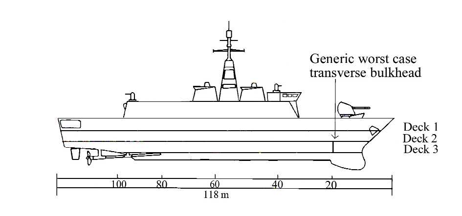

The operational requirements will be based around the capabilities that a transverse bulkhead on deck 3 at 19.2 m from the bow on a vessel 118 m long moving at 30 knots, see Figure 1, should be able to be fulfil. This is potentially the worst position for a transverse bulkhead due to the following reasons
Figure 1.
The position of the worst-case generic transverse bulkhead.
