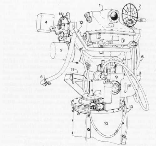

Mark 51 Director
Sketch courtesy of CPL
A simple, one-man instrument for 40 mm Bofors and also for 5-in guns at close-range targets.
1.  Mark 14 Gyro gun sight 8.  Power unit motor
2.  Elevation synchro unit 9.  Air power unit
3.  Air hoses 10. Pedestal
4.  Counterbalance weights 11. Body rest
5.  Right handle with firing key 12. Sight bracket
6.  Left handlebar with cage trigger 13. Electricity cables
7.  Open Ring Sight 14. Elevation scale
Take a motorcycle handlebar.  Mount it on a box about 2 ft sq.  Mount the box on a pedestal, and fix it so that the handle bars can move the box in bearing and elevation.
Mount an optic sight in the box.
Bend the handle bars so that the operator is comfortable holding the handle bars and looking through the sight.
Add a gyro with its axis pointed mechanically along the line of sight of the optics.  Apply electrical control circuits to the gyro so that when the operator is tracking a target in the optic sight, that the lagging deflection angle of the gyro, from the line of sight is measured electrically, in bearing and elevation.
Run this information through a few more gadgets, and set a range input of 5,000 yards fixed.
Add some synchro transmitters, to send this information to the 40 mm guns.
Add a trigger switch to the left handle bar.  This trigger is used to "cage" the gyro.
When searching for a target you kept this trigger pulled or closed.  This kept the gyro caged.
Caged means that the gyro was mechanically held, so that its axis was parallel to the line of sight of the optics of the Mark 51 sight.  The Mark 51 sight by the way was called the Mark 14 gun sight.
