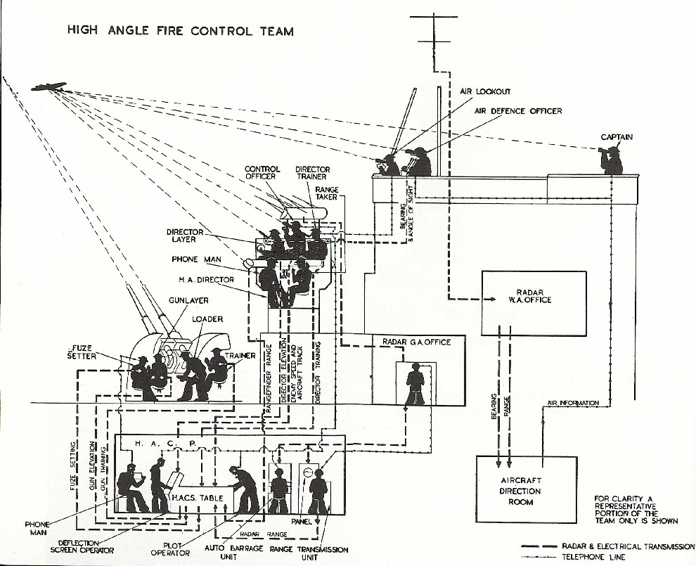

Operation of the HACS Mark IV
Anti-aircraft fire control during the World War Two period required a large crew of highly trained individuals and specialized equipment (see Figure 1).
Figure 1
Composition of the Team and Air Defense of the Ship
G.A. = Gunnery Aircraft Radar Set
W.A. = Warning of Aircraft Radar Set
Sketch from B.R. 224/45

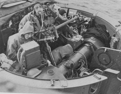

The H.A. director crew (see Figure 2) were the primary element in the H.A. control system.  The layer and trainer had telescopes with undisturbed (non-gyro compensated) lines of sight.  These transmitted director setting and training data to the HACS table.  Training of the director was hydraulic or, in the event of failure, by handwheel.  Elevation was by handwheel, supplemented by hydraulic drive from the level corrector.  The height finder could move independently of the layer.  The control officer was kept on target by the layer and trainer.  In his binoculars was a graticule which he needed to keep aligned on the target aircraft's fuselage.  The control officer also estimated the target's speed.  All of this information was transmitted to the HACS table automatically.17
Figure 2
Close-up view of a Mark IV HACS Director
Note the tight working space, typical for most directors of this era
IWM Photograph

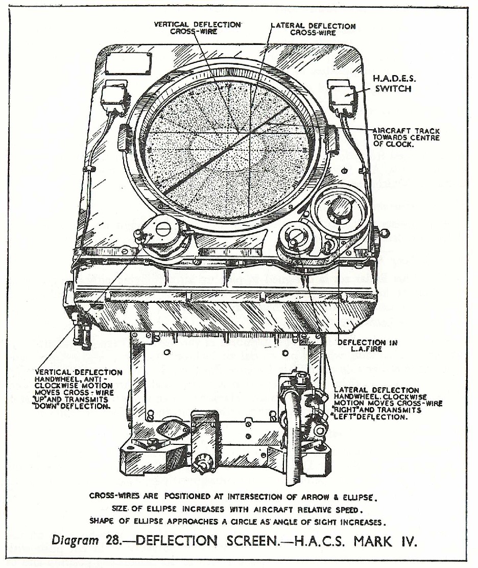

The target's future position was determined by the Deflection Screen (see Figure 4).  The Deflection Screen projected an image of a ring with an arrow-type pointer at the center of the screen.  The pointer represented the future position of the aircraft and the ring represented the present position.  The direction that the arrow was pointing at represented the target's course.  The ring was tilted by a drive from the future angle of sight and the image on the screen gave an ellipse of the required shape.  The size of the ellipse was adjusted by moving the projection unit by an amount calculated by dividing the target's speed by the average of projectile velocity.
With the present position on the circumference of the ellipse and the future position at the center, the vertical and lateral deflections were given by the distance of the present position from the center, measured parallel to the ellipse axes.  The screen operator continually moved a pair of wires, which were perpendicular to each other, such that the intersection of the wires was also the intersection of the pointer and the ellipse.  This information, together with corrections for the ship's own movement, convergence and drift, were fed to the table which was then able to calculate the azimuth of the guns.

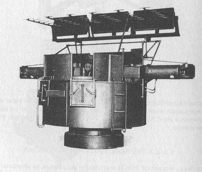

The Mark I through Mark III directors were similar in principle to the Mark IV director but they were solely hand-trained.  The Mark I was designed so as to fit nicely into the existing High Angle Control Positions (HACP) already present on the Queen Elizabeth and Royal Sovereign classes.21  Mark II had some provisions to allow the fitting of power drives, but these were not actually fitted until much later.  The major difference between Marks I/II and the Mark III was the increase in rangefinder baselength from 12 feet to 15 feet (3.7 m to 4.6m), this larger length being continued in the Mark IV.  Like most RN rangefinders, these were coincident types.  It should be noted that coincident rangefinders have some difficulty with aircraft targets compared to stereoscopic rangefinders, as the coincident type of rangefinder depends upon matching the edges of two views of the target to make a “cut,” which is difficult to perform on a fast moving aircraft.  The Mark III was designed to use hydraulic power for training and elevation, but not all of these units had drives as built.  Mark III* added a roll correction hydraulic drive.  Mark III directors had radar added during the war as shown in Figure 3.
Figure 3
HACS Mark III Director after having radar added
The Mark 4 HA/LA was the last pre-war version and was similar to the Mark III* but used magslips to control elevation, training and roll correction.  Some units had local power control for training and elevation.  With the addition of the GRU, directors were reclassified as Mark IVG, and with the further addition of hydraulic cross-level stabilization they were reclassified as Mark IV(GB)HA. The ‘B’ modification allowed remote power control of the director from the Table when in a blind-fire mode.  As noted above, most Mark IV directors had a radar antenna added during the war, usually Type 285.  The weight of this installation caused some problems, as it could overload the drive units.  With the Type 285 radar, these directors weighed about 5.5 tons (5.6 metric tons).  Most Mark IV directors had been upgraded to the Mark IVGB standard by the end of the war.

B.R. 224/45's description of the anti-aircraft battery's functioning aboard a large British warship
See Figure 1 for crew positions and general layout.
436.  As in low angle firing so in high angle firing, the successful defense of the ship against hostile aircraft is brought about only by good teamwork, backed up by constant practice and an understanding by each member of the team of the difficulties and complexities of each other's jobs.   The high angle control team is as follows:
(i) The Air Defense Officer (A.D.O.)
437.  He is the captain of the team and on him rests the responsibility of seeing that no enemy aircraft approaches without being engaged.  He chooses the targets to be engaged from the air defense position at the rear end of the bridge and by means of the Air Defense Officer's Sight, indicates the approaching enemy aircraft to whichever H.A. director he wishes.
(ii) The Assistant Air Defense Officer.
438.  Assists the A.D.O. and operates the A.D.O.'s sight on the other side of the air defense position.
(iii) The Long Range Warning Radar Set Operator
439.  This Radar set is designed to pick up aircraft flying either singly or in formation at long ranges.  The information that it receives is passed to the Action Information Centre, and thence to the A.D.O.
(iv) The Air Lookouts.
440.  These are very important members of the team.  There are six air lookouts, three each side, who sit on special air lookout seats, fitted with binoculars, in positions either side of the Air Defense Position.  Each lookout has an arc for which he is responsible.  He sweeps that arc continually through his binoculars reporting as soon as he sees an aircraft.  Having seen an aircraft he must keep it in his binoculars, until he receives further orders from the Air Defense Officer.
(v) The High Angle Control Officer.
441.  He sits in the high angle director and having been put on to the aircraft to be engaged, by the Air Defense Officer, he gives the necessary orders to the calculating position for opening fire and subsequently spots the bursts on to the enemy aircraft.
(vi) The High Angle Director's Crew.
442.  Consists first of all of the director layer and trainer, who keep on the enemy aircraft continually, the layer operating the angle of sight cut push with his foot as soon as he is on.  This burns a light in the calculating position and in the air defense position and tells these positions that he is “ON” the enemy aircraft.  The director layer also fires the guns electrically, by means of a trigger, during the time that the fire buzzer is ringing.
The other member of the crew is the rangetaker.  He gets a “cut” as soon as the director layer and trainer are on and subsequently throws off and re-cuts continually, so as to get as accurate readings as possible.
(vii) The Radar Ranging Set Operators.
443.  The aerials of this set are mounted on the director and are moved when the director is laid and trained on to the target.  Thus they are pointed continually at the enemy and Radar ranges are passed to the H.A.C.S. Plot, from the Radar Ranging panel operator.
(viii) The Crew in the High Angle Calculating Position.
444.  The operators of the H.A. table are given the estimated course and speed of the aircraft by the Control Officer and from this information, together with the measured range and movements of the director as it follows the target, are calculated the gun elevation, training and fuze number. These are passed continually to the guns.  The H.A. table also sounds the fire buzzer automatically at regular intervals.  This tells the director layer when to fire.
(ix) The High Angle Guns' Crews.
445.  The gunlayers and trainers must follow the movement of electrical pointers in the elevation and training receivers.  It is also extremely important that the correct sequence of setting fuzes and loading the fuzed shell into the guns is carried out by the guns' crews, because each shell carries a fuze that is only correct for that particular moment.  These points must never be sacrificed to achieve a higher rate of fire.
B.R. 224/45 description of the Deflection Screen
Figure 4
The HACS Mark IV Deflection Screen
425.  In Diagram 28 [Figure 4] will be seen a picture showing the deflection screen of a Mark IV table.  An optical system inside the table throws on to the screen the image of a circle, which is engraved on a plate.  This circle can be tilted by a mechanism, according to the angle of sight and will thus show on the screen as an ellipse, whose shape will vary according to the angle of sight.
The optical unit inside the table is moved according to [u / a.p.v.] so that any variations in these will show on the screen as changes in the sine of the ellipse.
The track of an aircraft is also shown on the deflection screen by means of a wire, which is pivoted at the centre and rotated in agreement with an arrow in the Control Officer's binocular.  The Control Officer, in the H.A. director, keeps this arrow along the fuselage of the aircraft and thus the correct track is sent down to the deflection screen.
426.  The deflection screen operator sits facing the screen, looking at the ellipse.  He has two handwheels, one either side of the screen, marked Vertical Deflection and Lateral Deflection.  These are connected to wires, which can be moved across the face of the screen.  The duty of the deflection screen operator is to keep these deflection wires over the intersection of the wire marking the track of the aircraft and the ellipse.  By moving the deflection wires from the centre of the ellipse to the point of intersection, the deflection screen operator measures the vertical and lateral deflection of the aircraft and sends these away to the red pointers at the elevation and training receivers at the high angle guns and so gives the guns the necessary “aim-off,” both for elevation and training.

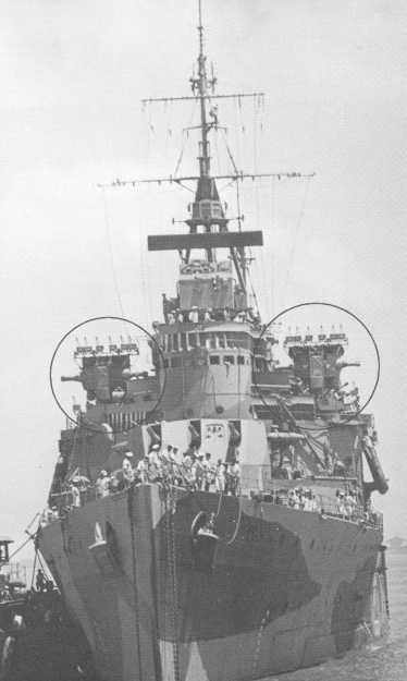

Fig. 5
HACS Mark IV Directors with Type 285 Radars
HMS Nigeria in June 1943
The radar antennas are known as “Yagi” (Fishbone) arrays
USN Photograph

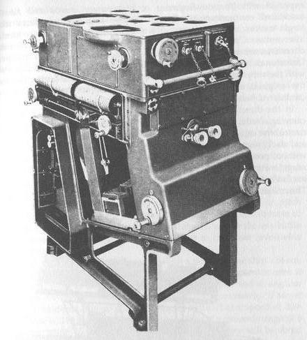

Fig. 6
Fuze Keeping Clock (FKC) Mark 3
Note the lack of the plotter
HMS Collingwood
