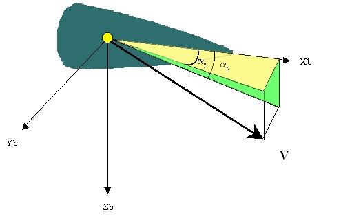

Cd is a dimensionless parameter that represents the drag acting on the shell for a specific flight condition.  Common flight conditions include Mach number or velocity, altitude, and angle of attack Angle of attack, a is the angle between the body centerline axis and the prevailing wind. (Figure 1)
Figure 1
