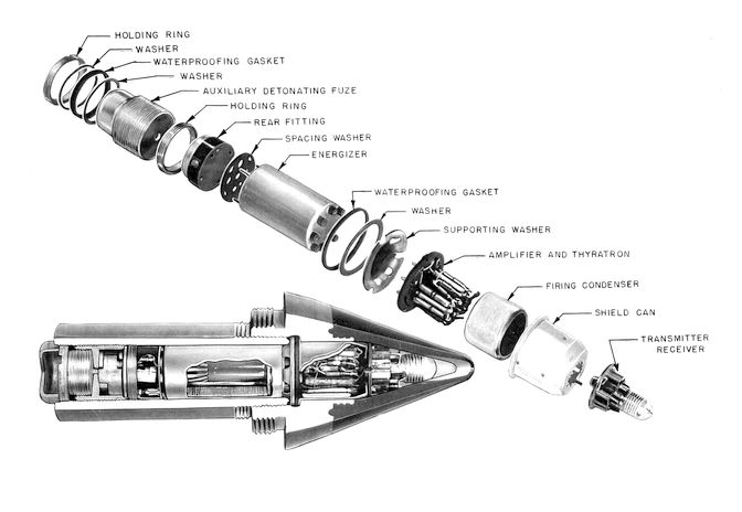

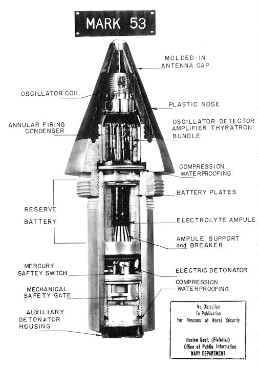

Section T of the Applied Physics Laboratory at Johns Hopkins University, under the direction of Dr. Merle A. Tuve, was assigned the task of developing and overseeing the production of a proximity type of fuze for the Navy's 5" guns which were their primary long-range anti-aircraft weapon.  The theory was simplicity itself:  The fuze would contain a miniature radio transmitter-receiver which would send out a signal.  When the signal reflected back from the target reached a certain frequency, caused by the proximity of the target, a circuit in the fuze closed firing a small charge in the base of the fuze that detonate the projectile.

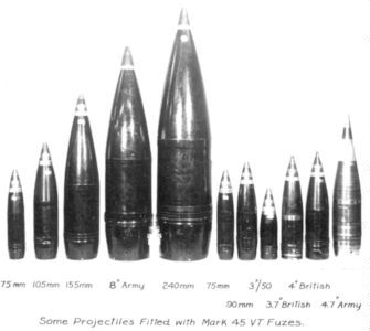

tech-075_Shells1.jpgThe theory may have been simple, but the problems encountered in all steps of development and after the fuze was released for use by the fleet were formidable.  Consider, that the components in the fuze, including tiny glass vacuum tubes, had to withstand the shock of being fired from a 5" gun.  This set back force of 20,000 g's is instantly generated by accelerating the projectile to a 2,800 foot per second muzzle velocity.  In addition, the shell's brief trip through the gun's rifling grooves starts it spinning at 25,000 revolutions per minute.  Safety features had to be built in to protect the men handling the ammunition in transit and aboard ship.  Additional safety features were necessary to prevent the shell from exploding too soon after firing which would endanger the gun crews and nearby ships.  A self-destruct feature was also necessary to prevent dud fuzes from falling into the hands of the enemy.  Moisture was an ongoing problem that had to be dealt with and there were many other problems that are too numerous to mention here.

Exploded view of the Mark 53 Fuze
