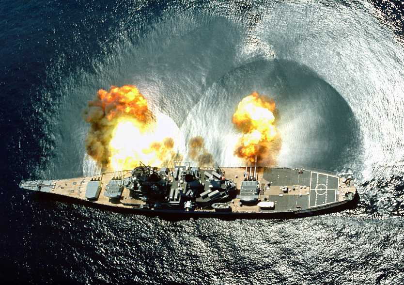

![]() USS Iowa BB-61 firing a 15-gun broadside
in 1984
