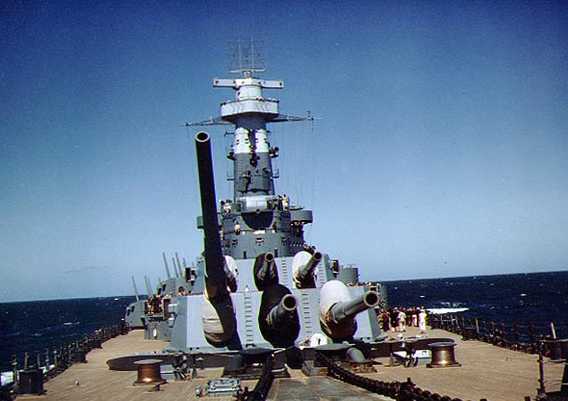

Bow turrets of USS North Carolina BB-55
Note CXAM-1 radar above the main battery director, which dates this photograph as being sometime shortly after 27 August 1941
U.S. Naval Historical Center Photograph # 80-G-K-13971
