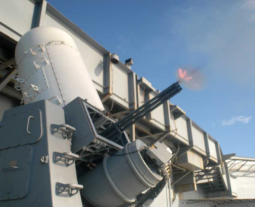

Phalanx Block 1 during a Pre-Aimed Calibration (PAC) test-fire on 20 February 2003 aboard USS Carl Vinson CVN-70
US Navy Photograph No. 030220-N-9273C-027
