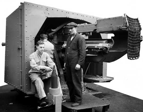

4.7"/45 (12 cm) Mark IX gun in CPXVIII mounting under construction at Vickers.  The net at the back of the gun was to slow the ejected cartridge casing and the workman on the left appears to be setting a time fuze.  Note the cartridge on the loading tray.
Photograph copyrighted by The Vickers Photographic Archive catalog number 4931 and used here by courtesy of Lynn Dunning, Development Officer.  A typing error at Vickers has the mounting mis-identified as "Mark VIII."
