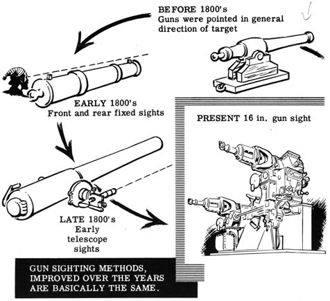

Sighting consisted chiefly of setting the guns in azimuth, and of leveling them by eye. Sometimes allowance for the curvature of the trajectory was made by “sighting by the line of metal.” This was done by aligning the top of the breech and the top of the muzzle with the point of aim, causing the gun to be elevated by the amount of the taper of the gun from breech to muzzle.
瞄准方式主要是把炮对准目标方位,然后用目测调整炮口高低。有时会以“炮身瞄准“方式来补偿不平直的弹道。通过使用炮尾及炮口上缘对准瞄准点,由于炮身后粗前细造成斜度使口上扬来完成校正。【见附图2】
【图2: 从18世纪以前瞄准大致方向,到19世纪初叶的前后固定瞄准具,到19世纪末叶的瞄准望远镜,再到现代16寸炮瞄准镜。】

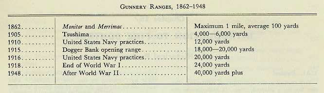

The table, GUNNERY RANGES 1862-1948, shows how gunnery ranges have been increased during the past century. Since these improvements represent specific attempts to develop particular phases of fire control, each of these aspects will be separately treated in the succeeding paragraphs.
1862-1948炮术射程这张表显示出过去一世纪以来炮术射程是如何增加的。这些进展代表不同时期对火控发展的特定尝试,每一面向将在下文中分别叙述。见附图0
图0:1862-1948炮术射程的进展,从上到下分别为南北战争,对马海战,美海军演练,多格尔沙洲海战,美海军演练,一战结束,二战后。

15A4. Gun sights
15A4. 火炮瞄准具  【见上图2】
Gun sights introduced early in the nineteenth century consisted of fixed front and rear sight points so adjusted that the line of sight across their tips was parallel to the bore of the gun. The only advantage was a definite means of leveling the gun at the point of aim, although elevation could be adjusted within small limits by regulating the coarseness of the sights taken across the points.
十九世纪初的火炮瞄准具由炮身前后两个尖点构成,视线通过两尖点顶端就得出与火炮炮膛平行的瞄准线。虽说可以靠瞄准具上的刻痕来微调炮口仰角,但实际上唯一的好处就是有了一个可以确实使炮身对瞄准点作出高低调整的工具。
Improvements in guns and powder during and after the War Between the States resulted in such increases in range and accuracy that graduated gun sights became a necessity. A movable leaf, adjustable both vertically and laterally, was fitted into the rear sight. Correction for drift caused by the adoption of rifling in big guns was approximated by inclination of the rear sight bracket.
南北战争中及结束后对火炮和发射药的改进带来射程及精度的增加,也使得带刻度的火炮瞄准具变得更有必要。人们在后瞄准座上安装一个小齿轮以上下左右移动。并且靠稍微偏移后瞄准座来修正大型火炮因膛线所带来的偏流【即表尺的概念。】。
Toward the end of the nineteenth century, the sight telescope was developed. The sight telescope was mounted in such a way that the line of sight could be offset from the axis of the bore of the gun to correct for range, drift, and relative motion of gun and target. Elevation scales were graduated in accordance with proving-ground data, and the weight and composition of powder charges were carefully regulated. An improvement in operation was effected by installing two sights and dividing the responsibility of keeping on target between the pointer in elevation, and the trainer in train.
到十九世纪末叶,瞄准望远镜被开发出来了。这种瞄准镜底座是可以转动的,使得瞄准线能够偏离炮膛轴线以修正射程,偏流及火炮与目标之间的相对运动。仰角标尺对应试射场的射程资料刻出度数【即对应射表的弧尺。】,发射药的重量和成分也加以规范。在操作上的一个改进是装设了两具瞄准镜,由俯仰手负责炮口高低瞄准,回旋手负责炮口左右瞄准,来分担瞄准目标的任务。

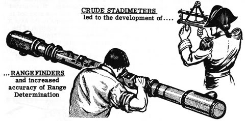

Range measurement. When it was found that estimation of range was no longer sufficiently accurate, mechanical aids were sought. The first of these was the stadimeter, adapted to this purpose by 1898. The stadimeter was crude, and was accurate only for short ranges, but it embodied a principle used later in the coincidence rangefinder, which provides sufficient accuracy for surface fire control under good visibility conditions. Later the stereoscopic rangefinder was developed, giving equal accuracy for surface targets and making it possible to range on fast-moving air targets. Recently radar has carried range accuracy out beyond the shooting limit of the guns, and is not dependent upon clear visibility.
距离测量:当人们发现距离估测不够精确时,就去寻求机械辅助。第一种为这个目的列装的仪器是1898年【美西海战】采用的标杆测距仪【貌似只有美军使用这种工具,同时间欧洲已开发出光学测距仪了。】标杆测距仪精度不高,仅能应付短距离,但它其中的一项原理后来应用到重合式光学测距仪上,后者在能见度良好的情况下能对水面目标提供足够精确的数据。稍后立体式光学测距仪也发展出来,除了精确测量水面目标之外,还可以测快速移动的空中目标。晚近雷达更能提供超越火炮射击距离之外的精确测距,而且不必再依赖清晰的能见度。【见附图3
【图3从粗略的标杆测距仪到精确的光学测距仪。】

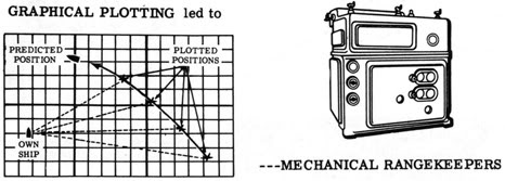

Early in the twentieth century, an improvement in computation was brought about by graphic plotting. A graphic plot (for a surface target) consists of a series of ranges and bearings of the target, set down on paper, from which it is possible to determine the approximate course and speed of the target. This method provided a valuable supplement to the paper computation, but was soon supplanted by a further refinement, which plots range against time. The advantage of this procedure is that it makes possible the determination of the rate at which range is changing (range rate) and so makes it feasible to predict the range at the end of the time of flight. In practice, the fire of main-battery guns was controlled in this way for a time, but the important contribution of graphic plotting was that it established the basic principle of the mechanical rangekeeper.
二十世纪初,作图法为这些计算工作带来了改进。人们在图纸上标示出一连串目标(水面目标)的距离与方位点,将点连成一线后就可以判定目标的大致航向与航速。这个方法有利于弥补书面计算的不足,不多久又添了另一项改进,那就是将距离点与时间轴对应起来。这个作业方式的好处是可以判定距离变动率(距离变化的程度)从而有效预测弹丸飞行时间结束时的射程。在实用上,有一阵子主炮台火炮射击就是用这种方法控制的,但是作图法的最大贡献还是为机械式射程计算仪建立起基础原理。【见附图4】
【图4从作图测量到机械解算。】

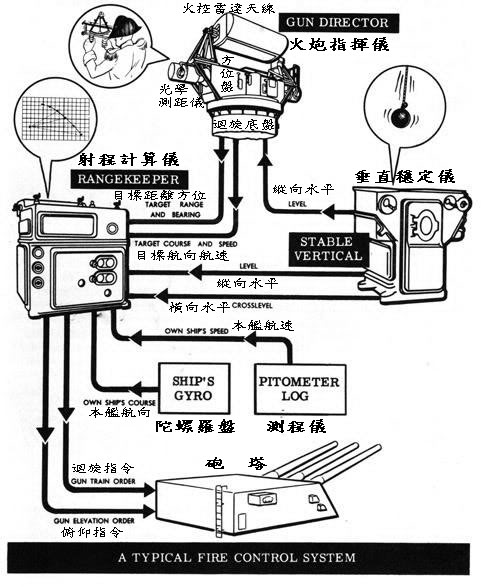

【图6典型的现代火控系统构成,反映一个半世纪以来的进步。】
Under the old system of pointer fire, each gun was practically an independent unit. Each gun crew worked out its own sight settings, and except for being told when to commence and when to cease firing, each gun crew fired at will. As fire control and communications improved, it became evident that a single control officer should direct the work of the battery. From his elevated station he could estimate or measure range, could transmit sight settings to the guns, and could observe the fall of shot and estimate corrections known as spots.
在老式的瞄准手射击时代,每一门炮都是各打各的。每一炮班装定自家的瞄准具,从得令开火到受命停火,这中间都是自由射击。当火控与通讯改善后,便顺理成章的由单一的火控官来指挥炮台作业。从挑高的位置它可以分析或测距,可以下达瞄准设定到火炮,更可以观察弹着据以估算落点修正。
It soon became evident that with all guns firing individually it was almost impossible to spot with any accuracy. Buzzers were later used at all the guns to give the signal for firing. This was an improvement, but the guns still went off at various times during the sounding of the buzzer. The next step was the installation of a master firing key in series with the firing circuits of all the guns. When that master key was closed, all ready guns fired.
显而易见的这种各炮一哄而上的方式是没法儿仔细修正落弹的。后来就给各炮安装下达开火令的响铃。这算是一项改进,不过听到响铃后开炮声仍是此起彼落。下一步就是装设一个串联到所有火炮发射线路的总按钮。按下总按钮,所有的火炮就发射了。
The control station soon became much more than a station from which verbal orders were issued. A new instrument called a director was installed there. This was at first a pair of master gun sights that were offset by the necessary lead angles and sighted on the target. The movements of these sights were transmitted electrically to the gun mounts, which duplicated sight motion by matching pointers. Later a director having a built-in analog computer, one part of which became known as a dummy gun," was used. The movements which positioned the dummy gun were transmitted to the mounts, to be followed in elevation and train by matching pointers or, in later installations, by automatic control equipments.
很快的火控室就不仅是限于下达口头命令的部门。一个叫做指挥仪的新仪器被装上舰了。一开始这玩意儿扮演像是“领头炮“的角色,上面装着两具瞄准镜,一具管提前角另一具管瞄准目标。这两具瞄准镜的动作以电气方式传达到各炮位,各炮位再按仪表读数复制瞄准镜的动作。后来有些指挥仪装上模拟式计算器,一部分这种设备被称为“假炮“。假炮的动作被传递到炮位上,各炮位跟随假炮动作的读数转动仰角及方向,在后来的装备上更交给自动控制设备去完成。
The dummy gun idea was eventually given up, but the director remains. It has taken on new functions, such as measuring range, bearing, and elevation, and spotting or otherwise correcting the solution of the problem.
假炮的概念最终被放弃,但指挥仪仍然存在。它承担了新的功能,像是测量距离,方位,俯仰,以及落弹修正和其它解算校正等。
Today the quantities measured at the director are sent to the computer in a protected plotting room below decks. The computer, in addition to solving the fire control problem and transmitting the gun orders to the gun, also sends signals to the director to keep the sights positioned on the target if the solution is correct. If the solution should be in error, some director systems are provided with devices whereby discrepancies between the ordered positioning rates of the director and the actual rates of the target can be measured and introduced as corrections to the computers solution. This procedure is known as rate control.
如今指挥仪测量的数据被传送到甲板下受保护的绘图室内的计算器。计算器除了解算火控课题及传输火炮指令外,还要传送控制信号到指挥仪,只要解算正确,会转动指挥仪瞄准镜对准目标。如果解算有误差,某些指挥仪系统装置可将目标位置实际变动率与解算变动率之间的误差加以测量并回传给计算器改正解算值。这个过程称为变动率控制。

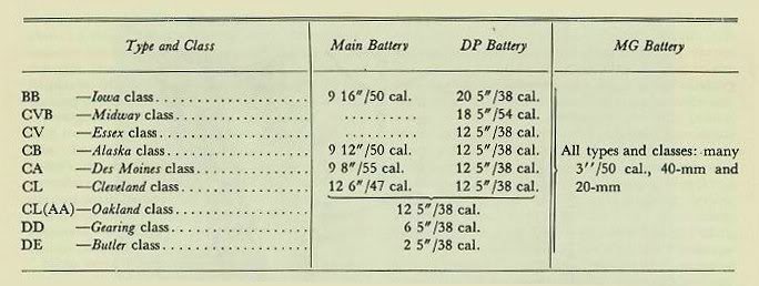

舰种级别与火炮:                           主炮台            两用炮台           机关炮台

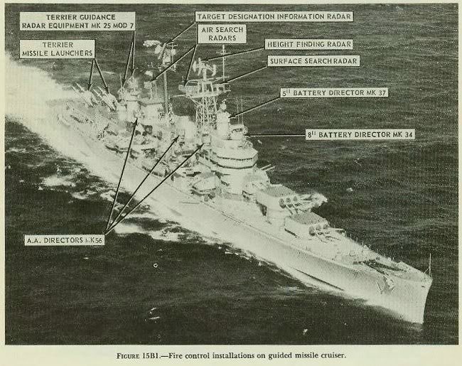

Some typical examples of combatant ship gun batteries are shown in Figures 15B1 and 15B2.
下图15B115B2显示数种战斗舰艇的炮台组形式。
导弹巡洋舰火控设备:舰岛由前往后为8寸炮MK34指挥仪;5寸炮MK37指挥仪;对海搜索雷达;高度测定雷达;对空搜索雷达;目标标定信息雷达;MK25 TERRIER导弹制导雷达设备;TERRIER导弹发射器。右舷是三座MK56防空指挥仪。
萨勒姆级巡洋舰火力配置:沿中线由前往后为13寸炮座;23寸炮座;主炮组1号炮塔;主炮组2号炮塔;15寸炮座;前副指挥仪;前主指挥仪;后主指挥仪;后副指挥仪;65寸炮座;主炮组3号炮塔;舰尾11123寸炮座。沿右舷由前往后为20毫米炮座;35寸炮座;353寸炮座;右舷副指挥仪;793寸炮座;55寸炮座;及20毫米炮座。左舷同右舷由前往后对称配置。

Cruisers have fire control installations similar to those of battleships, except that there are only two directors for the dual-purpose battery (i.e., the secondary battery on cruisers with turrets; the main battery on AA cruisers). Figure 15B1shows the fire control installations on a guided missile cruiser,
巡洋舰火控装置与战列舰相似,不过只有两座两用炮台指挥仪(在有主炮台的巡洋舰上供副炮台用,在防空巡洋舰上供主炮台用。)15B1显示导弹巡洋舰的火控装置。【只有阿拉斯加级萨勒姆级有两间绘图室。只有萨勒姆级有四座两用炮台指挥仪,见图15B2。】
NOTE: Radar has replaced the optical rangefinders in the turrets of some of the later cruisers.
原注:在某些较新的巡洋舰上雷达已取代了光学测距仪。
U.S.S. Boston (CAG-l). On guided missile cruisers of this class, the after 8-inch triple turret and the after 5-inch twin gun mount have been replaced by two twin Terrier missile launchers.
波士顿号(CAG-l)。在这一级导弹巡洋舰上,舰尾的三连装8寸炮塔及连装5寸炮座已被两座Terrier飞弹发射器取代。
