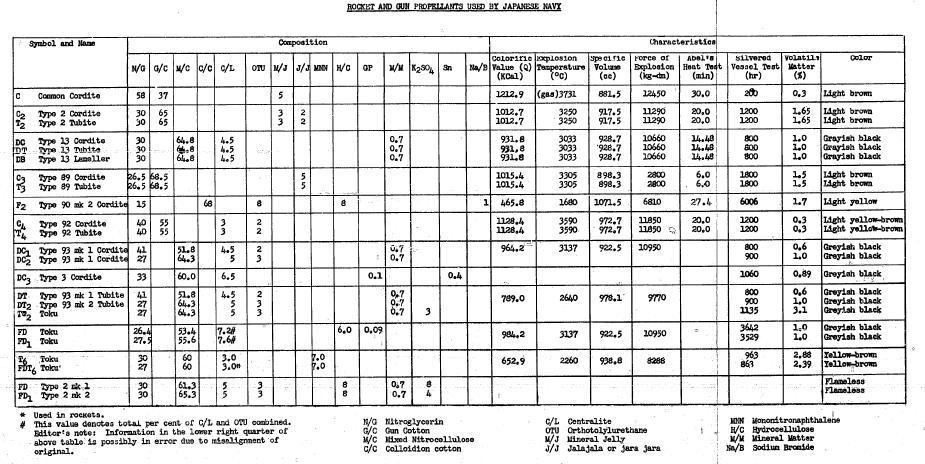

The nominal diameter of the Japanese cords was given in units of 0.1 mm (0.004").  For example, the Japanese propellant 80DC was cordite with cords of 8.0 mm (0.315") diameter.
Table from "Report O-10-2:  Japanese Propellants - Article 2, Rocket and Gun Propellants - General"
